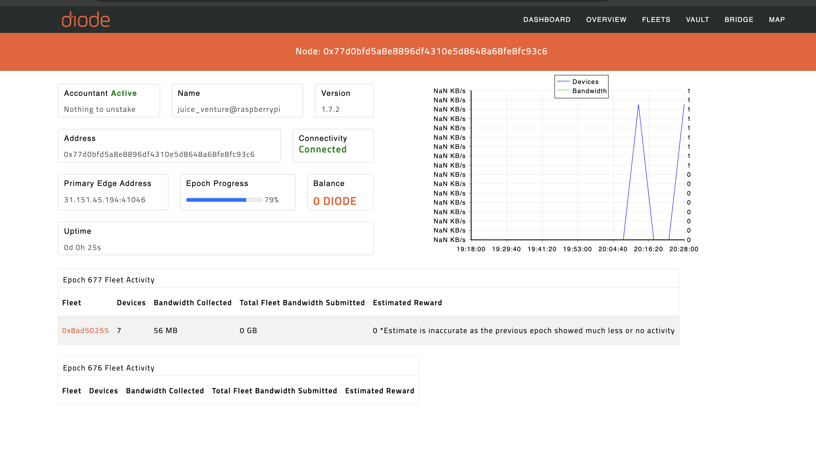

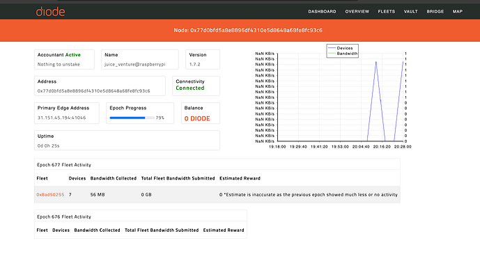

Update:
you need to “sudo snap run diode-node.info”
pi@raspberrypi:~ $ sudo snap run diode-node.info
== Diode Node 0x77d0bfd5a8e8896df4310e5d8648a68fe8fc93c6 ==
Version : 1.7.2
Accountant : 0xe4579341b84249808a994410166b12fe9ace71b2
Uptime : 230
Connected Devices: 0
Connected Peers : 22
Current Epoch : 677
Ticket Score : 0
Previous Epoch : 676
Ticket Score : 0
Dashboard : Diode™ Network
trying to find out next how to fix
Connection failed in ssl.connect()

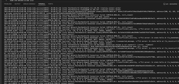

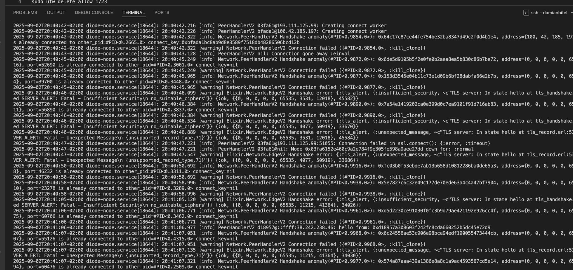

Still seeing a lot of this maybe it needs to sync will let it run overnight
